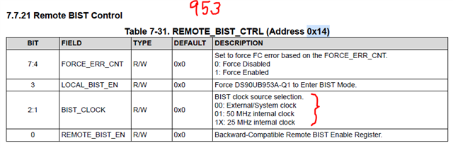

In https://www.ti.com/lit/ds/symlink/ds90ub953-q1.pdf, BIST_CLOCK [2:1] in REMOTE_BIST_CTRL (0x14) has following description
BIST clock source selection.
00: External/System clock
01: 50 MHz internal clock
1X: 25 MHz internal clock

  • Hello Abhishake,
    Thank you for your patience!
    The picture below shows register description of register 0xB3 in the DS90UB954 datasheet.
    It states that "This register field selects the BIST Clock Source at the 953 Serializer. These register bits are automatically written to the CLOCK SOURCE bits (register offset 0x14) in the Serializer after BIST is enabled. See the appropriate Serializer register descriptions for details."
    So, depending on the clock source and clocking mode you are using in your system, you can select the appropriate BIST clock source.

  • Hello Abhishek,
    The BIST clock frequency is controlled by the BIST_CLOCK_SOURCE field in the BIST Control register. This 2-bit value will be written to the Serializer register 0x14[2:1]. A value of 00 will select an external clock. A non-zero value will enable an internal clock of the frequency defined in the Serializer register 0x14.
    For example, if your system is operating in the synchronous mode, you would set 0xB3[2:1] and 0x14[2:1] as 1X (25MHz internal clock).

  • Hello Abhishek,
    Thank you for clarifying your question.
    Usually you run BIST “at speed” meaning that the frequency that the application would be running at in order to emulate the data path that you would have in normal use case. To do this, usually an external clock is used. If you are using 953 in synchronous mode, the "external clock" is the back channel clock from 954. If you are using 953 in non-sync mode, the "external clock" is the CLKIN to the 953.
    We recommend always using external clock with BIST.
