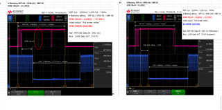

  • Hello David,
    Our customer captured six waveforms as attached.
    The setting condition and expected error flag are below.
    H Blanking HFP:60 / HPW:50 / HBP:50
    #1 SYNC DELAY : 21(HEX)/33(DEC) SYNC ERROR (0xE5:80) --> Over 32, should not be Error.
    #2 SYNC DELAY : 06(HEX)/06(DEC) No ERROR (0xE5:00) --> Below 32, should be Error.
    #3 SYNC DELAY : FF (HEX)/255(DEC) SYNC ERROR (0xE5:80) --> Over 32, should not be Error.
    H Blanking setting   HFP:10 / HPW:140 / HBP:10
    #4 SYNC DELAY : 21(HEX)/33(DEC) No ERROR (0xE5:00) --> Aligned with the description
    #5 SYNC DELAY : 06(HEX)/06(DEC) No ERROR (0xE5:00)   --> Below 32, should be Error.
    #6 SYNC DELAY : 8F(HEX)/143(DEC) SYNC ERROR (0xE5:80) -- Over 32, should not be Error.

  • Hi David,
    In our captured waveforms, you can see actual SYNC DELAY time on Right side waveform in the pdf file which attached yesterday's message. Have you found our pdf file?
    eg. #1. capture. SYNC DELAY setting is 33dec, on Right side waveform there is 0.0135us x 33 = 0.4455us delay. It is perfectly matched with register setting.
    And the Hactive line length value is 1280 as in DSI tuner parameter which we had previously attached.
    Here is our questions would you please give us your suggestions to move forward.
    Q1: Isn't this your requested capture of "the SYNC_DELAY between the end of HSS on the DSI to the beginning of HSS on the LVDS side" ? Or something else?
    Q2: Then what can you find from this waveform? There is an error 0xE5:80, even we meet "more than 32dec" SYNC DELAY requirement.
    How can we fix this error flag?
    Q3: On the datasheet recommendation SYNC DELAY should be more than 33dec, but acctulay we can see an error at 128dec and not have an error at 6dec.
    What is involved another parameter to rise 0xE5:80 flag?

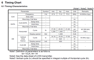

  • Mochizuki-san
    Can the LVDS panel support both blanking parameters?
    David
  • Hi David,
    That is correct LCD panel support 1440 and 823 as below.
    Anyway we expected interface condition between LVDS output and LCD panel will not cause of Sync Error from the device, but we can see failed image on the panel.
    Mochizuki
  • Mochizuki-san
    I am trying to understand the two captured scope waveforms. On the failing waveform, what is the pulse that I have circled in red?
    David
  • Hello David,
    That is a packet from DSI.
    We can see this packet at earlier position when H Blanking setting is HFP:10 / HPW:140 / HBP:10.
    Mochizuki
  • Mochizuki-san
    If you look at the timing diagram I shared earlier, the SYNC delay is defined as the end of HSS on the DSI input and the beginning of HSYNC on the LVDS output. For the case of HFP 60, I wonder if the circled pulse is the HSYNC from the DSI source.
    David
