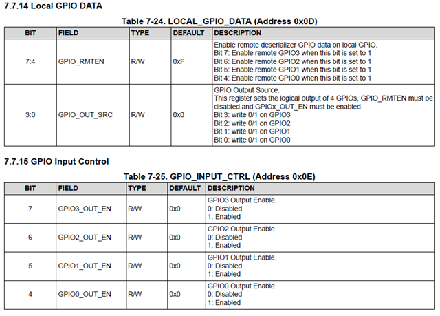

Hi ,
I'd like to set up the related registers of  DS90UB953/DS90UB954 to control GPIO.
I want to control the GPIO output of DS90UB954 by H / L and read it with the GPIO input of DS90UB953.
 GPIO1/3(954)OUTPUT  ⇒ GPIO0/1(953)
The setting registers are as follows.GPIO1/3(954) OUTPUT is High
954
Reg 0x0F : 0x20    GPIO_INPUT Disable
Reg 0x11 : 0x83    GPIO1 OUTPUT H
Reg 0x13 : 0x83    GPIO1 OUTPUT H
953
Reg 0x53    READ STATUS
The above command is sent, but L is output from 954
Are there the registers that have to be changed?
