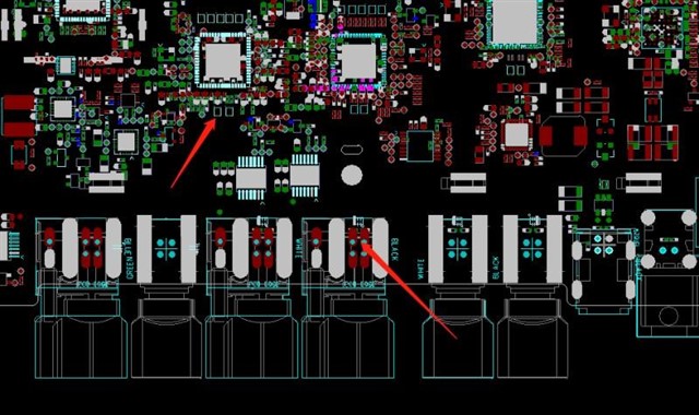

Hi team,
The customer is layouting for 941 and 948.
Here is their spec:
2 links, 2.9G, two 75mm vias, the board stick is 1.6mm.
The position is like this:
They want to know is there any problem for signal transport using two vias.
Do you have any suggestions for them? : )
Cathy
  • Hi Cathy,
    What layer is the HSD connector and FPD-Link IC on? Is the connector on top, and the IC on bottom? Is the connector surface mount or through-hole?
    Via and connector stubs should be avoided, also you should have differential vias next to the signal vias.
    Logan
