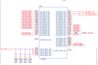

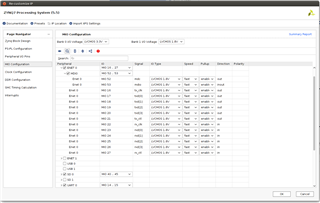

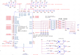

We are using a DP83867IR on a custom board. The PHY is connected to the PS a Xilinx Zynq 7000 series part.
We have been using Vitis' echo server program to test this part and get things connected. We are also using the emaclite code that comes with Vitis that is supposed to support TI parts.
We have become aware that our board has issues with the LED Strapping and it comes up in Mirror mode. So I have been modifying the code to disable Mirror Mode by writing to register 0x0031.
After this Mirror Mode issue was fixed, we now get passed the auto-negotiation phase and an IP address gets set to and bonded to 192.168.1.10 @ port 7 without Vitis throwing any errors.
At this point, I would expect to be able ping from my computer (that is on 192.168.1.8) or create a telnet connection with the board. I receive no reply from the board and there are no interrupts on the port. We have tried debugging in several ways, and have gotten to the point of asking for some help on this issue.
I will include a dump of the registers after the auto negation has occurred. Please let us know if there are any red flags we should be aware of, or if there are any debugging steps to take after auto negotiation has taken place that can give us more information.
We are in a time crunch to get this PHY working, as we have several that we will be using on our products, any help would be greatly appreciated.
Thank you!

  • Hello Gerome,
    I received permission to send some screenshots of our schematics. Below should be some images of how we have the PHY hooked up to the FPGA in our design.
    As an aside, the "PS" (Processing System) is part of the ZYNQ FPGA architecture that allows one to access peripherals, such as the TI PHY, from the arm processor on the board. This allows systems to use these devices directly without any custom user firmware/"glue" logic. A description of the Xilinx IP involved in this can be found here https://www.xilinx.com/products/intellectual-property/processing_system7.html
    The MAC interface is software based, and for the moment, while we are testing we are using emacps https://xilinx.github.io/embeddedsw.github.io/emacps/doc/html/api/index.html .  This will likely be changed out to a Linux-base driver as we migrate to placing the Petalinux OS on the system.
    I have tried to link with several different devices, (PC port, Ethernet switch, and Insignia USB2.0 to Ethernet Adapter), all of these devices have auto-negotiated, but fail to allow for ping and come up with the same register readout as above. I checked a few times in each instance to make sure the network connection was set to a good static IP on the same domain as the FPGA.
    Please let me know if these images are readable (as I add them to this forum, they seem to be very small and fuzzy when I expand). I may need to send directly through email if this is an issue.
    The Phy implemented in our system:
    Connections to the XC7Z030
    Connections within the Xilinx IP.
    In addition, this webpage has a few diagrams explaining a little more of the data flow for these FPGAs. https://xilinx-wiki.atlassian.net/wiki/spaces/A/pages/478937213/MPSoC+PS+and+PL+Ethernet+Example+Projects Please let me know if you need any more information on how the system is set up.
    Thanks!
    -Scott
  • Hi Scott,
    Thanks for all the information. It seems like the cable (MDI) portion of the PHY works correctly. So the issue looks to lie in the MAC (MII) portion of the PHY. The fact that every link partner you have tried with the PHY has produced the same result leads me to look at this portion. For ping to work, when a PHY connects to another PHY, the MAC1-to-PHY1 interface, the PHY1-to-PHY2 interface and PHY2-to-MAC2 interface all have to be functional. Since PHY1-to-PHY2 interface works (there is link) and PHY2-to-MAC2 (assuming as these are working devices), the MAC1-to-PHY1 interface looks to be where your issue lies. I noticed in the strap registers that you have a shift in RGMII (Reg 0x6F = 0xD70, where RX shift is 0 but TX shift is 2.5ns). Is this intentional?
    Sincerely,
    Gerome
  • Hello Gerome,
    Thanks for pointing the strapping out. The 2.5ns delay was not intentional, we should be PAP (supplying 1.1V to the VDD1P1 on the device) and the .pdf for the device indicated that the first few bits for register 0x6F are for RGZ mode.
    Just in case this was the issue, I physically strapped LED_1/LED_2 to mode 0 to make Reg 0x6F = 0xD00. [I also strapped LED_0 so the device would no longer be in mirror mode on bootup.] I will attach the new register dump, taken after the auto negotiation, to this post.
    Changing values associated with 0x6F still did not help resolve the issue we are having. I agree that we should be looking at the MAC1-to-PHY1 interface. Are there any other points that we should take a look at to help debug this issue?
    I thought I should include, the only other area I see the RX/TX delay timing being set is within the default Xilinx code for TI devices. The register 0x86 is set to 0xA8 and 0x32  is set to 0xD3. This should be setting the delay for RX and TX clocks and enabling the shift mode (they are calling this TX/RX tuning within the comments of this code).
    Please let me know if there is anything else we can check into. With the change of the strapping I am now able to use un-modified code from Xilinx echo server and get an auto-negotiation to happen, but still no telnet connection or Ping.
    Thanks!
    -Scott
