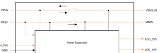

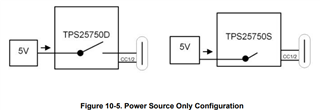

According to the datasheet p.51, Figure 10-5, 5V supply is connected to one of two terminal. Does it mean 5V power supply can be connected to either PPHV or PP5V?
However I saw the block diagram shows only PP5V can supply "Power Supervisor", so that 5V should be connected to PP5V, PPHV should be opened, is my understanding correct?
