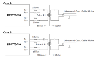

In the case using with 50ohm unbalanced cable,
Then the resistor for TX+/- can use 25ohm with a 1:1 balun?
Or shall be use with a 1:1.4 balun to use 50ohm for TX+/- ?

Would it be possible to ask for a drawing of what is going on? I'm afraid I am not understanding how the 25ohm, 50 ohm and balun are interacting with each other.

Sorry for made you confuse.
I'm thinking below Case A.
I think the ideal design in this case would be Case B, but I could not found good candidate of a balun.
To get balanced, I'm thinking to change the two resistors on Tx to 25ohm.

Referencing section 8.2.1.1 of the DP83TD510E datasheet, you are saying that RTX1 and RRX1 (as well as RRX2 and RTX3) are all 25Ohms?

Becasue RRX1 and RRX2 are for input, and input impedance of RX+/- should be big enough, they were not discussed here.
I just focused on those values that impact signal transmittion, impedance maching.
Just use RTX1/2 25ohm instead of 50ohm, others remain the suggested value in detasheet.

You are saying if RTX1 and RTX2 are 25 ohm rather than 50 ohm, however, this doesn't match your picture you provided. Wouldn't in your case RTX1, RTX3 = 25 ohm, RRX1, RRX2 = datasheet value, and RTX2, RTX4 = short? Please advise. Maybe a table such as Table 8-1 or a figure with all resistances like Figure 8-2 might make everything clearer.

Sorry for my typo. not RTX1/2 but RTX1/3.
When you see the Figure 8.2.1.1 on the datasheet,
RTX1+RTX2 is 25ohm (Originally 50ohm)
RTX3+RTX4 is 25ohm (Originally 50ohm)
It is to reflection when using unbalanced 50ohm coax. cable with 1:1 balun.
If the mixed resister value should not be such small value,
then I will consider uisng 1:2 balun and use bigger resisters.

From team, "Our transmitter design in DP83TD510LR cannot support Case-A shown from the query on E2E."

Then I'll consider suing Case-B or using 1:2 balun with relative bigger resisters for RTX1+RTX2 and RTX3+RTX4 to keep the return loss minimum.
