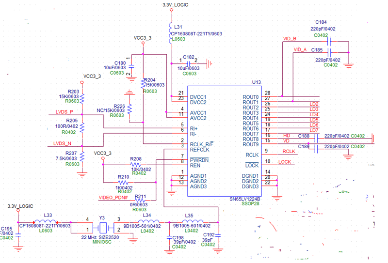

Dear Sirs,
My customer changes the solution from DS92LV1212A to SN65LV1224B due to EOL.
However, the SN65LV1224B test fail for replacement and there is no display and no RCLK output.
The product is an industrial endoscope with around 5~7m cable, and schematics as below.
Please help to give the suggestion about the issue.
