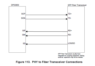

    Also please confirm whether the Singal detect PIN connection from the FIber module is required for the PHY. Shall I connect permanently to GND on the Phy side?.
    RGMI to 100FX configuration has been cross-checked with TI support and confirms register values.
    Also, please share more details about  " Rx and TX shift/align mode" Presently we have not configured the same. what changes

    SD should be connected to LOS/SD of the SFP as shown here in the datasheet :
