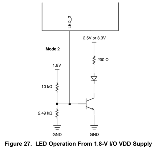

We would like to confirm "8.5.3 LED Operation From 1.8-V I/O VDD Supply" on the datasheet.
On this figure, there is no resitance at base pin of transistor to limit base current.
Is it possible to configure without resitance(for current limit) at base pin?
We assume there are following background;
-By inserting resitance, it affects to strap setting
-LED0~2‗pins are high impedance output, output current is limited.
Is our recognition correct?
Kind regards,
Hirotaka Matsumoto
  • Hello Hirotaka-san,
    What is the base current expected from this transistor? Usually we should be ok to use the above configuration with low base current.
    LED_2/0 are 50ohms output drivers during LED functionality and are high impedance only during the stap latching time.
    Vikram
