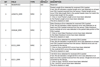

Hi team,
My customer is DAHUA, and they have counter a question about 962 register value reading. First they read 0x7A = 0F, 0x7B=59, and the second time 0x7A=00 and 0x7B=00 without any additive operation, The confusing point is that how can the error clear itself without any operation, or is EQ function of clearing the error?
