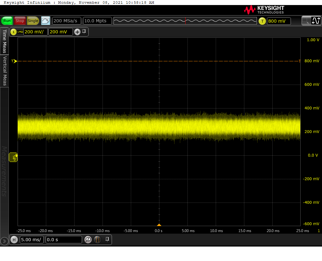

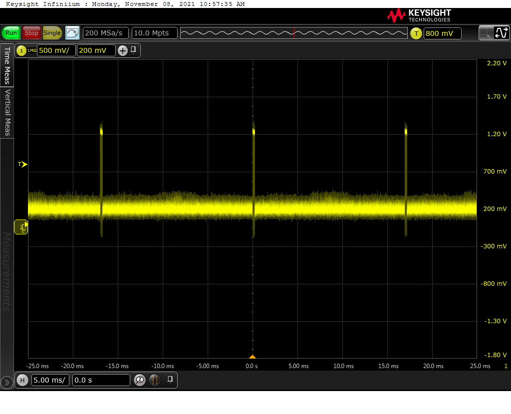

And this is what the DSI clock:
DSI Clock
and DSI data:
DSI Data
look like.
