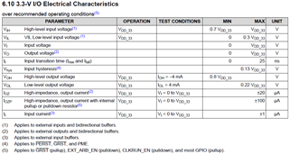

The GPIO Input transition time (trise and tfall) is stated Max 25ns in Chapter 6.10 of the data sheet, but it doesn't satisfy the I2C-bus specification.
Is it okay to trust this value (Max. 25ns) when using EEPROM.

  • Greetings,
    Typical rise/fall time is 0nS. Therefor it means we can operate the part at faster rise/fall time than 25nS. If EEPROM rise/fall time is slower than 25ns - for example 30ns - then based on simulations and across temperature this does not meet device requirement. Please correct me if i mis-understood this question.
    Regards ,,Nasser
  • Hello Nasser,
    Thank you for your reply.
    If the above reply is correct, I think it is impossible to connect the I2C specification EEPROM and this IC. Because, I2C specification EEPROM rise / fall time is  300ns (Max.) in Fast-mode according to the following document.
    UM10204 I2C-bus specification and user manual (pololu.com)
    We will use the I2C specification EEPROM (S-24CS01AFJ-TB-G) that rise / fall time is 300ns (Max.). We are concerned that this EEPROM cannot be used.

  • The I²C specification allows for a 300 ns fall time because large buses have a large capacitance. This will not be the case for the short connection between the XIO and the EEPROM, so the fall time is likely to be below 25 ns.
    The I²C rise time depends on the pull-up resistance, and will always be larger than 25 ns. All the boards with XIO2001 out there work, so I guess the datasheet is wrong, at least for the I²C pins.
