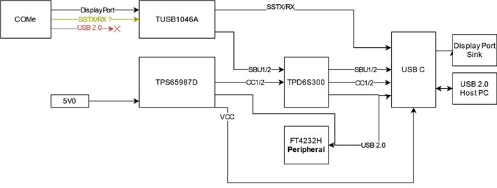

Normally USB-C in Alt mode would Have the USB2, USB SS and Display Port from the Host, in this case, a COMe board.
I have a USB-C Connector that we would like to use as a Display Port output from a COMe or as a connection to a USB 2.0 FTDI Peripheral. Both do not need to be active at the same time. Is this possible?
Is the TUSB1046A is ok without a USB SS connection?
If it does need USB SS is the circuit ok without the corresponding USB 2.0 from the COMe?
I could add a USB2.0 Mux if needed to switch between FTDI USB2.0 and COMe USB 2.0.
