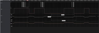

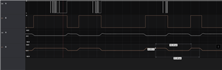

  • Hello Eric,
    We use modbus poll and Yabe programs for modbus and Bacnet communication tests of our devices. While testing after connecting the device we set some parameters through the program so we can be sure the communication is okay. We test the device peer-to-peer.
    You can see the attached waveforms of bus communication as digital and analog signals.
  • Nihan,
    Are the bottom two waveforms the bus signals? I'm curious how they're reaching 4.337V if the supply is only 3.3V on the VCC pin. Is there another device on the bus that is set to 5V and pulling the voltage up?
    Eric Hackett
  • Eric there is just Moxa Uport and Salaea logic analyzer on the bus. I checked the signal again thinking that we might measure wrong signals. You can see the bus signals at the attachment it is maximum 4V and I think that moxa might be the reason.
