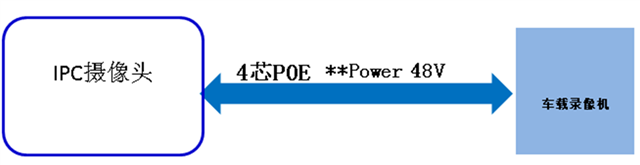

After discuss with customer
They need chip must support 4-core POE,
DP83TG720S-Q1 seem unmet spec , could you please help suggest a new solution ,THX
Thank you for the input.
When you mean 4-core did you mean GBE with four pairs?
Sreenivasa
Thank you for the inputs.
I am not able to understand the block diagram.
If you are looking for GBE solutions we have the DP83867 for copper only and DP83869 for copper or fiber.

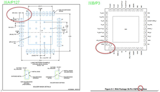

1. If the part of the Ethernet port, customer needs to configure the POE mode, whether there is a related reference SCH?
2.There is a deference for the pin sequence defined in Figure A/Figure B below. Which one should correct?

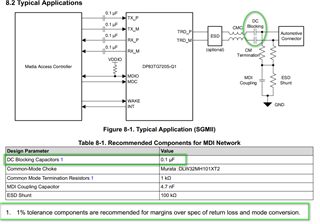

3.As shown on page P115 below, it is mentioned that the DC Blocking capacitor is a 1% accuracy material. Is the requirement too high? Could 10% be used? (BTW. Serdes Coupling Cap. 0.1uf/10%)

We do not have a reference schematics for POE.
Please orient the pins in the same direction and both will look same.
For the tolerance, the 1% is typically for the resistors. Please refer the EVM for more details.
