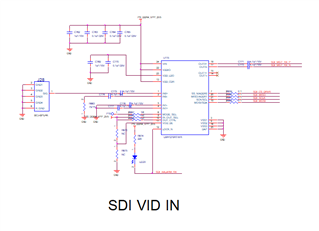

LMH1219 can lock in 6G-SDI mode,but no lock in 12G-SDI mode.
The test cable I used is a 12g cable from canare, with a length of 3M. Is it because the minimum value of adaptive equalization is too large for a 3M long cable? Is it necessary to reduce the threshold of adaptive equalization?
