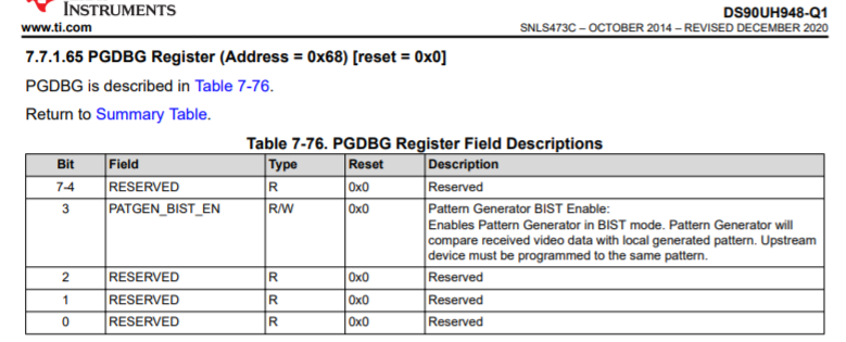

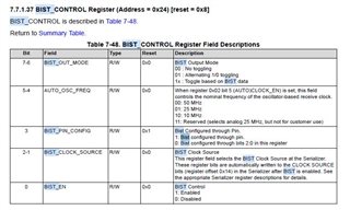

    Since BIST mode on the 941AS does not actually output video, I might suggest instead of enabling BIST on the 941 side, an alternative form of BIST/PATGEN that does output video is to use the PATGEN_BIST_EN bit on 948, when the 941 is set to the same PATGEN output and enabled; either PASS or PATGEN_BIST_ERR can be monitored at 948 to observe/count errors.
    Or if you just want to enable patgen to see a display, try disabling BIST.

    What is this new reg dump? Have you tried patgen without BIST or patgen in BIST mode?
