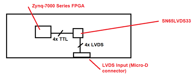

We are using SN65LVDS33 to transmit 4 LVDS signals: CLK, D0, D1, and D2.
The CLK is being run at 100 MHz.
When any 2 of the 3 data channels are enabled (e.g., D0 & D1, or D0 & D2, or D1 & D2), the CLK signal integrity (SI) at the output of the receiver (i.e., the single ended side) is satisfactory.
When all 3 data channels are enabled (i.e., D0, D1, and D2), the CLK SI of the single ended signal deteriorates, and worsens as more signal edges are added to the data pattern being transmitted. The CLK SI at the input side (i.e., the LVDS side) remains good.

All signals on the LVDS side are good. Traces are routed with the correct impedances, though they are longer than recommended by the TI app notes for LVDS signals.
Note that if we run the CLK at 50 MHz instead of 100 MHz, the CLK SI remains good across all cases.

    My apologies, seems I have misread the part number. This device should operate at 100MHz clock. Do you happen to have a block diagram of your setup? What is the peak to peak voltage on the LVDS side?
  • Hi Malik,
    I created a simple block diagram of the circuitry. See image below.
    The peak-to-peak voltage on the LVDS side is roughly 1V; see waveform capture below (Ch2 = green = CLK LVDS, Ch3 = blue = CLK TTL).
