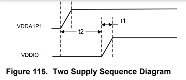

In the datasheet Figure 115 shows parameter t2 which is the time from VDDA2P5 andVDDA1P1 to VDDIO.
In table 101 t2 states the maximum of 50ms but the minimum is not specified at all implying there is no minimum?
Can VDDIO be powered up in advance of VDDA2P5 and VDDA1P1?
This would result in t2 being negative which would appear to be OK according to table 101?
