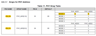

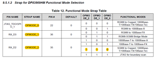

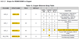

Could you please look and confirm I have the lines strapped correctly for SGMII mode and forced 100M MDI mode?    No mirroring and default PHY address.  Any other concerns for hard strapping?  I pretty much am looking to for 100M mode copper for the software guys and a default address.
Pins 33,34 pulled low
Pin 22 pulled low ; Pins 35, 36 pulled high
Pins 45 ,47 pulled high ; Pin 38, 46 pulled low
