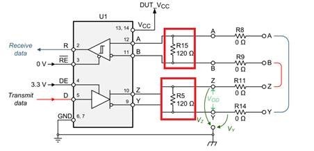

Part Number: THVD1452
Hi Team,
The customer had reference our EVM schematic, they place 120 ohm as the RL value.
The question is that do we have RL 120 ohm criteria? I had checked the DS. We only have RL 54 ohm criteria in it.
Mike

Mike,
As Clemens said, the overall termination resistance requirement is the parallel combination of 100-120 ohm resistors on the bus.
Eric Hackett
Hi Eric and Clemens,
Get it, thanks for your support!!
Mike
