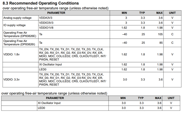

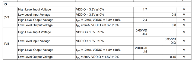

The datasheet of DP83822 does not specify the input level/threshold requirement for XI clock input when using external oscillator, just mentioned 'CMOS-level oscillator'.
My question is if this input level/threshold voltage is related to its VDDIO or AVD voltage? Can XI pin accept 3.3V crystal oscillator output while the device is powered from 1.8V VDDIO and AVD?
Thank you!
