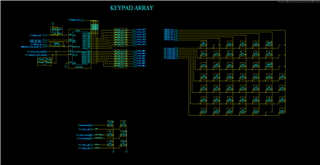

My customer uses TCA8418RTWR.Sometimes it is found that the key fails, and the measurement result is K_ Int is always low,What's the problem? Thanks.
  • Jimmy,
    Is it possible to share a schematic?
    Eric Hackett

  • Hi Jimmy,
    The INT pin is an active low so a key press should assert the INT pin low. If K_INT is the INT trigger then you should read the key event register to see which key was pressed.
    This sounds like you need to have the software poll the device to read the key event register until the K_INT deasserts the INT pin.
    -Bobby

    We also encounter a new problem. The problem shown in the following will not appear on the BGA encapsulated chip, but the problem shown in the following will be encountered on the new QFN encapsulated chip. The driver is the same.
    [operation steps]
    1. Press "1" and "3" simultaneously in the text input box, or press "1" and "3" quickly
    [expected results]
    Correct input, only "1" and "3"
    [actual results]
    "123" will be entered
  • Hi Jimmy,
    I think the issue has to do with way our device samples keypad presses, in particular the loading on the row is large in your set up so we may need to modify the schematic you currently have a bit. Are you able to short the 1k resistors on the row and then add a ~10k pull up on all the rows to Vcc? This should fix the '123' issue you're seeing because it speeds up the rise time between strobe sampling on the columnns.
