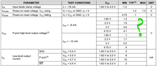

VDD- 3.3V
- We are using ALL IO ports as output pins, source current of 0.3mA
- In datasheet page no 5, VOH min only mentioned
- For source current 0.3mA what will be the VOH Min Typical and Max
- Please mention worst case scenario as well
VDD- 3.3V
Use linear interpolation; see [FAQ] What is the output voltage (VOH or VOL) when the output current is X or the supply voltage is Y?
At 3 V, the worst-case output impedance is 50 Ω (the typical value is about half that). An output current of 0.3 mA results in a worst-case output voltage of 2.985 V.
