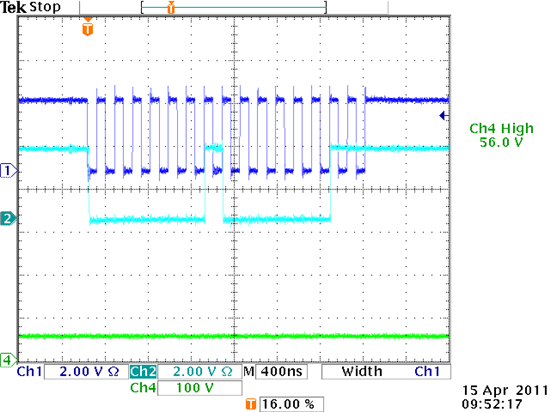

    #2 Here are two scope plots.
    The 1st is primary side SCLK and SDO data
    The 2nd is secondary side SCLK and SDO data
    This was waveforms taken in-circuit while trying to measure 54Vdc. As you can see whole pulses are just missing.
    Reading: http://focus.ti.com/lit/an/slla284/slla284.pdf and refering to 1.2 LF-Channel Operation (since 150Mbps is used in relation to alot lower datarate) these ISO chips are not edge-triggered and thus if there was noise on the leading edge I would expect the ISO7240M to then aquire the data at the next internal OSC clock but as you can clearly see it isn't even transmitting the pulses.
    I sorry but I am going to have to recomend such a chip is not used.

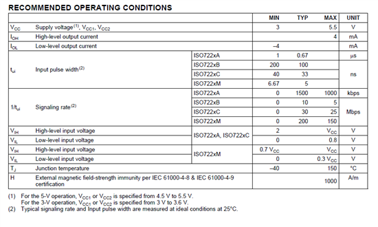

    I would also like to point out some errors in the datasheet. Max and typical are the wrong way round
    http://focus.ti.com/lit/ds/symlink/iso7220a.pdf
  • Jon,
    in regards to the data sheet "errrors", its not an error but an unlucky marketing aproach to show-case the isolators maximum speed. Basically the MAX column shows the  GUARANTEED maximum data rate, while the TYP column shows the typical possible maximum data rate. It is confusing and we plan to change this in future data sheets.
    With regards to the dual isolators versus the quad isolator design, they do have slightly different designs. We are going to investigate the quad isolators to see where this discrepancy might originate.
    Unfortunately at this moment I can only suggest to either sticking with the two dual isolators or moving your data rate away from the LF to HF transition range if using the quad isolator. I can fully understand your decision to not use the quad isolators at this type of frequency range.
