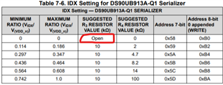

Hi team,
I'd like to know about setting R3 for IDXpin.
R3 is set to 10kΩ to set address 7.
However, it changed to OPEN due to the revision change of the datasheet.
Is there a problem with R3 set to 10kΩ?
Sincerely.
Kengo.

Hello Kengo,
Can you please clarify which previous version of the datasheet you are referring to? (Maybe share a similar picture)
You should follow the latest revision of the datasheet to set the correct 7-bit address.
Shruti
Hi Shruti,
Thank you for your reply.
I have seen revD.(www.mouser.com/.../ds90ub913a-q1-555909.pdf)
Of curse, I know we should follow the latest revision of the datasheet.
But, I’d like to know the impact if I do not notice the revision change and leave it as it is.
Sincerely.
Kengo.
Hello Kengo,
There isn't any big impact and no issue if R3 is 10k as long as the voltage ratio of VIDX/ V(VDD_n) is still 0 if intended.
Shruti
