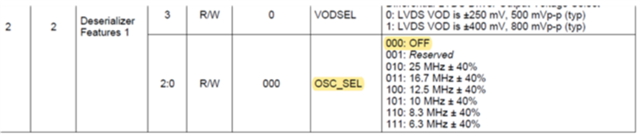

    I don't believe TXCLKOUT is necessarily tristate if OSC_SEL is "000". In order to use the Oscillator output, OSC_SEL must not be "000".
    OSC_SEL controls the OSC output highlighted above. So if OSC_SEL is "000", TXCLKOUT doesn't necessarily have to be tristate, it just won't be able to use the clock output generated by the deserializer. Does this answer your question?
    Ben

    Yes your understanding looks mostly correct. "If OSC_SEL is "000", TXCLKOUT is TRI-STATE" is not fully correct, as there are other parameters for a TRISTATE output (as we discussed before with the state table). But generally I think you have the correct understanding of it. Do you have any further questions?
    Ben

    I think what you are referring to is this image:
    The purpose of the above chart is actually to show the ability of TXCLKOUT to use the Oscillator as an output, rather than the clock received by the serial stream. If OSC_SEL was '000' the sections of "OSC Output" would not have any valid clock. So, if OSC_SEL is '000', TXCLKOUT would output the received input clock if there is one available, as you can see in this table (TXCLKOUT 'Active'):
    This paragraph also describes what I am talking about:
    And, I understand that it is not desirable to check the status of output voltage of TXCLKOUT in the status of OSS_SEL(H or L).
    The reason is <your comment>, so “If OSC_SEL is "000", TXCLKOUT is TRI-STATE" is not fully correct”.
    Is my understanding correct?
    What I mean when I say not to use OSS_SEL  or OSC_SEL to determine whether TXCLKOUT is TRISTATE, I mean you should take into account the other parameters that impact the state of TXCLKOUT. These are shown in the table I posted earlier in this reply.
    So, in summary:
    • OSC_SEL controls the oscillator option, and not TXCLKOUT as a whole
    • OSS_SEL controls the state of data and clock (TXCLKOUT) output when in power-down mode
    I hope this helps!
