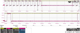

1-) We use the 3 supply mode and we enable 1V8 and 2V5 supplies at the same time. But 1V8 reaches the operational minimum limit of the PHY (1.71V) around 70us earlier than 2V5 operational minimum range(2.375).
2-) We give no reset to PHY from the FPGA and reset signal is pulled up with 1V8 rail which is IO Voltage level.
3-) I also see there is a power down requirement which says When powering down the DP83867, the 1.8-V supply should be brought down before the 2.5-V supply. Brought down means out of the operational limits or down to 0V or something else?
Pictures are power-up and power down scenarios of 1V8 and 2V5. If you cant see the pictures clearly, I can send an e-mail.
If you think some other measurements may help to investigate more, please let us know.

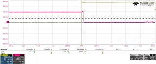

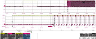

  • Good afternoon,
    Voltages are okay.
    Phy is supposed to be at address 1, we checked address 0(default) address 1 and 2 but we couldn't reach it.
    We gave a hard reset to reset_n pin(10us) to re-configure the PHY but it didnt work either.
    MDC was disabled for more than 200ms after releasing the reset.
    Power-up signal behavior of reset signal and MDC.
    Do you see anything wrong?
    Best regards
