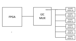

  • Eric,
    Hi, I think I got it. Let me chew on it for a moment and get back with you. I do have another question for you. Is it possible to have several I2C devices on one channel of the MUX?
    Thank you
    Joe

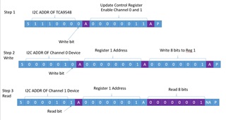

  • I think I have figured things out. Here is my understanding:
    In Step 1 you set the I2C address to the TCA9548, enable the Channel.
    In Step 2 write to to Channel
    In Step 3 read from the Channel
    Am I close?
  • When you enable a channel on the mux, it creates a direct electrical connection between SDA/SCL and SDx/SCx. All devices on all enabled channels are visible; you access them normally, and the mux ignores all transactions not targeting its own address.
    Please note that an I²C transaction is either read or write; you cannot do both write and read (as in step 3) without doing a repeated start.
  • Thank you very much. How about this:
  • You cannot write in a read transaction. And the start condition is always followed by the address/R/W byte.
    You have to write the register address first, and then read the value. (And this has nothing to do with the mux.)
