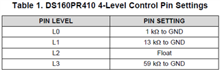

But DS160PR410 has another settings:
Is it really correct that same family chips has different L2 and L3 levels?
Hi Andrey,
Yes, it is correct. The two parts have different levels.
