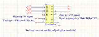

AM26LV32: Interfacing to 5V differential signal to get 3.3V output signals.
Part Number: AM26LV32
We are trying out AM26LV32 in one of our new product prototype and not sure about VCC, Inputs and output levels. Differential Encoder signals are coming from 12 inches away and going into C2000 DSP or FPGA. Is it ok to apply +5V differential signals to input and expect +3.3V output signals that can directly be fed into DSP?
Also, we have short distance on pcb and not sure we must need termination resistor or not along with Pull-up/down?
