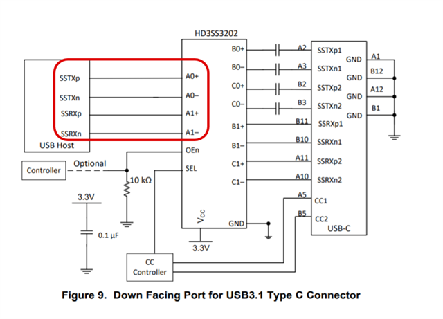

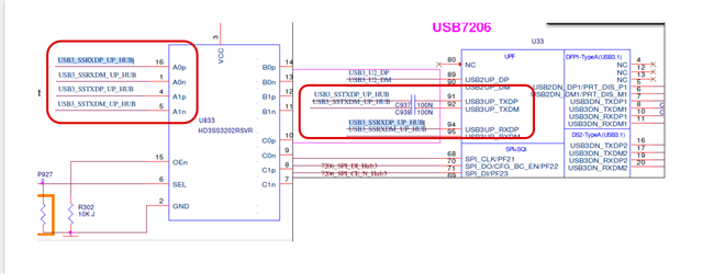

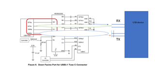

Hi team,
My customer has some concern about HD3SS3202,
In datasheet, there is no ac coupling capacitor in red circle.
but Microchip's hub need to add the capacitor in the TX, my customer wants to know, do he need to add the ac coupling capacitor in pin 4 and pin 5?
