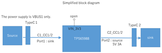

I have questions about work of port1:sink, port2:source on the TPS65988DH.
I have a problem that port2:source don’t work correct charging 5V 3A.

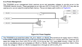

The power supply is VBUS1 only on my system. VIN_3V3 is open.
Then, port2:source don’t output 5V 3A. The output works 5V 0.9A.
When I tried to supply VIN_3V3, and port2:source output 5V 3A.
The datasheet describes that the TPS65988 is powered from either VIN_3V3, VBUS1, or VBUS2, and so I decided that the power supply of my system is VBUS1 only. VIN_3V3 is open. My system cannot connect 3.3V to VIN_3V3.
Could you tell me solution on this problem ?
