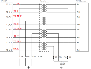

  • Hi Vikram,
    And also please confirm if we can swap pins like the red text in the below image.
    In our design, Phy is placed on the bottom side and a TH integrated Rj45 connector is placed on top of pcb.
    Because of this Pin swap is required to avoid vias
    AUTO-MDIX provision is available in this phy. Do we need to make changes in software or By default this will detect the signals?
    Please let me know if we can have this pin configuration as mentioned in the red text.

  • Hello Nandhakumar,
    It is better to open a new thread for separate question for better trackability.
    Now regarding the pin swapping : yes this connection can be supported. You may use mirror mode strap or register configuration of reg<x0031> to enable mirror mode.
    See section 8.4.6.6 of datasheet for further details.
