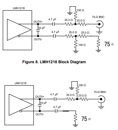

My customer wants to use LMH0002 with supporting MADI.
Can he also apply the following 6-dB passive attenuator block?
https://www.ti.com/lit/an/snla299/snla299.pdf
