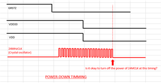

[質問3]
電源ダウンシーケンスについて教えてください。
電源を切る場合、XI端子の水晶発振器を停止した後、VDDとVDD33の電源を切ることをお勧めしますか?

    [Question 2]
    Is it okay to input the clock from the crystal oscillator to the XI terminal before VDD and VDD33 stabilize?
    [Question 3]
    Please tell me about the power down sequence.
    Is it okay to stop the 24MCLK (crystal oscillator) of the XI terminal after turning off the power of VDD and VDD33?
  • Functionally, having the clock start and stop after the device is powered on / off is ok, but the XI pin is not listed as fail-safe.
    JMMN
