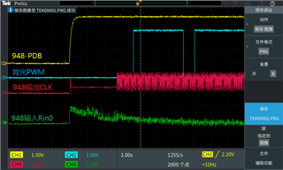

Hi team,
My customer now use 941 and 948 and found the screen flickers and when flickers, the lock signal is low.
1. Customer already try to only use 941 pattern, and even in pattern mode, the screen also flickers. (Because customer only do head unit side so they can't enable 948 pattern mode now)
2. The cable is only 30cm
The timing of 941 is :
The timing of 948 is :
The SCH is as following:

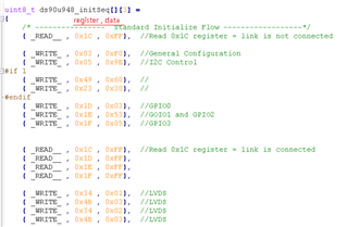

The register of 941 is:

The register of 948 is:
