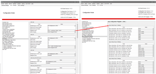

Please refer to attached figure.
First I connect a PD charger to VBUS1, and port2:source don’t output 5V 3A. The output works 5V 0.9A.
Next, When I execute DBfg(Dead Battery Flag Clear) of port2 by commands DBfg(Dead Battery Flag Clear) of F/W tool, the output of port2 switches output from 5V  0.9A to 5V 3A.
I have three questions.
(1)Why does not the TPS65988 output 5V 3A when Dead Battery Flag is set ?
(2)Why does the TPS65988 output 5V 3A when Dead Battery Flag is cleared ?
I tried doing DBfg command by F/W setting because the mass production cannot use I2C.
I succeeded in output 5V 3A.
But I concern that F/W setting is correct or not.
(3)Please tell me correct setting of DBfg command in F/W ?
    My setting is below.
