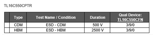

Hi Team,
Do we have data on the ESD Rating (HDM and CDM) for TL16C550CPTR?

Hi Yuya,
I have contacted our Quality and Reliability engineer to gather this data. Because this is an older device, we may not have certain ESD information for it.
Tyler
Hi Yuya,
Here is the ESD information we have in record.
ESD-CDM = 500V
ESD-HBM = 2500V
Tyler
