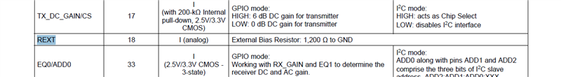

About the REXT pin, if there is any problem while using bias resistor of 1K instead of 1.2K?

The REXT provides internal Band-Gap voltage reference and bias current generation, it needs to be 1.2k to ground.
