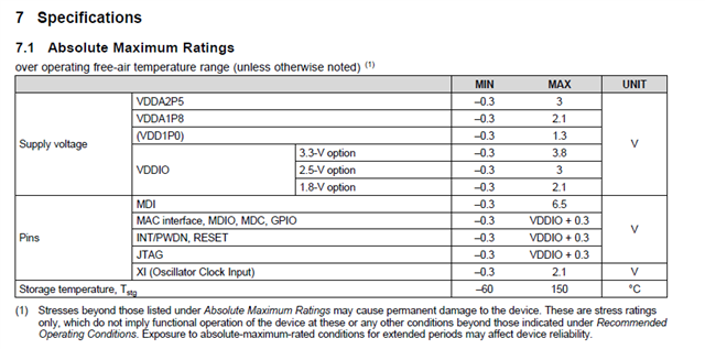

  • Hello, I do not see the absolute maximum current rating for the transmit receive data interface in the DP83867 data sheet (pins TD_P_A-D & TD_M_A-D). Clarifying my question, the short of pins I am referring to is not directly on the DP83867 device but on the RJ45 connector pins which are isolated by the magnetics. See attached illustration of the scenario I am asking about. Could such shorts to external RJ45 connector cause damage to the DP83867 given it is isolated with magnetics coil, as recommended? thanks - Bela
  • Bela,
    Yes, magnetics isolate the DC from RJ45 side to the PHY side. And shorting of RJ45 pins should not impact the PHY.
    Just for your reference, absolute max ratings are in the first subsection of "Specifications" :
