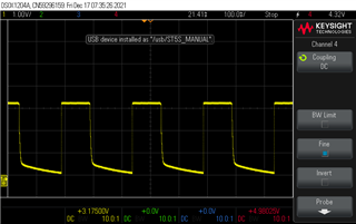

When connected to a passive 5V USB-C line, both the 5V line and the (internally converted by TPS25750) 3.3V line are stable. PPHV outputs 5V.

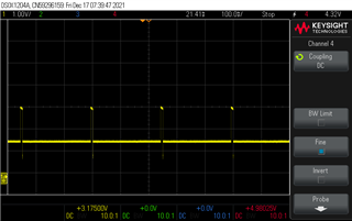

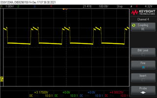

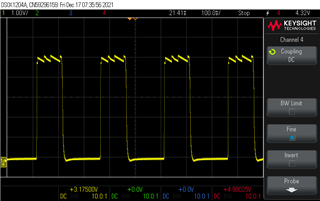

However, when we connect a 100W USB-C PD charger - all lines fluctuate including the CC line as you can see in the captures below. What is more, a soft clicking noise can be heard every time a peak is produced in the oscilloscope reading.
3V3
5V
PPHV
CC line
