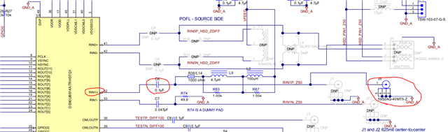

     1.914A  RIN1+ pin to J5 have C6 & L9 in EVM, what is the purpose of this section of the circuit? Will it affect LOCK? Can I connect capacitors in parallel with the RIN1+ pin? Maybe I can partially compensate for the Lock signal from the circuit. THX
    2.What are the reasons that usually cause loss of lock?
    3.In addition to the RIN1+ pin, what other PIN layouts and SCH will affect the loss of lock

    Here are the steps that I recommend taking here:
    1. Verify the total channel between SER/DES including cable, connector, and PCB. The measurements seem to only cover the cable portion of the link, but not the PCB. Usually if there is an SI issue in the design of either the 914A or 913A module, that would show up in the PCB, not the cable. I would suggest to get a TDR looking into the 913A board and then a measurement looking into the 914A board so we can see the impedance continuity at the connector interface first. Technically to get a total channel measurement the customer would need a probe station, but please have them start by getting TDR measurements looking into the SER and into the DES so we can see what the impedance continuity looks like. Use the edge rate of 150ps for the TDR measurement to match the typical rise/fall time of the DOUT CML driver

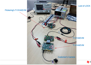

    2.We did a comparison, using the customer's Camera (ISX019, PIXCLK 99MHz) to connect to TI 914AEVM, to generate Parallel data in BT601 format and PIXCLK, VS, LS input to TI 913AEVM, and then connect COAX cable (FPD-LINK III) with Flickering's TI 914A! You can still find lost of LOCK as shown in Figure 1
    And Figure 2 is to replace Flickering's TI914A with a 914-to-USB Display board from one of the customers, and its LOCK will remain High
    >>>Please help identify where this test needs to be improved? Can we discuss it with customer next Monday?

  • Kygo,
    I'm confused on what the customer is trying to get from this activity. Are they trying to say that they have a faulty 914A unit? So they have populated that unit on a 914A EVM and they are using setup to propose that the 914A unit is faulty?
    If so before we make that conclusion I would suggest to measure the input jitter to the 913A EVM in that setup coming from the upstream 913+914 chain. At the end of the day, this chain will only work across PVT conditions if the input jitter provided to the 913A EVM is within the datasheet specifications. Keep in mind that when you make these back to back chains of SER->DES->SER->DES there will be a low frequency jitter accumulation through the stages that means the second 913A will see more jitter than the first and then that will translate to more output jitter on the 913A side that will make tracking the signal more difficult for the 914A at the end. There is expected to be normal variation between units within the datasheet limits so it is not conclusive to say that because one failed and the other passed this means the unit is bad (unless of course everything is within datasheet limits including power supplies, input jitter, etc).
