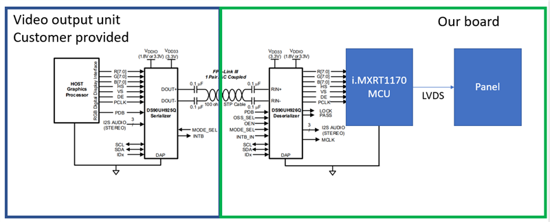

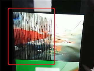

Hi Sir,
My customer found there is something wrong with the 926 display.
Please give me suggestion what point we need to check!
Thanks.
  • Hi Peter,
    Thanks for your question. I'm going to need more information to debug/investigate further.
    • Can you provide block diagram of whole system?
    • Does this happen when doing patgen from the SER or patgen from the 926?
    • Can you provide register dumps of both SER and DES?
    • Does this happen in one off case, or every display?
    Logan
  • Hi Logan,
    Here are the files for your information.
               Customer can’t do patgen from 925 because the unit is provided by our customer, the patgen of 962 looks normal, please see the attached video file of previous post.

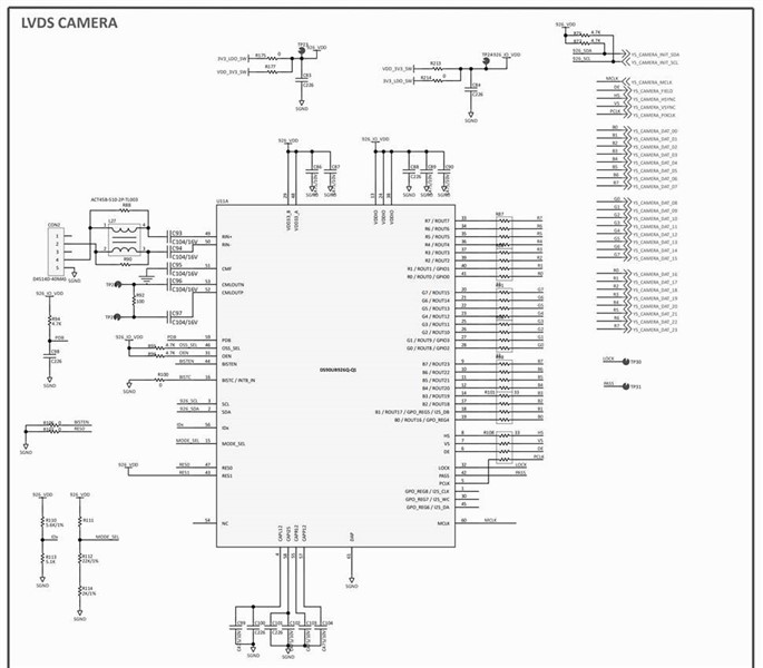

    BTW, for the impedance matching, what kind of meter needs for checking? LRC meter?
    Thanks.
  • Hello Logan,
    I also encountered a similar problem here, is there any document about the cable characteristic requirement between 925 & 926?
  • Hi Peter,
    • Please help me understand the project background, is this a customer return case where a few of many units have issue; or is this in development and no displays work given the current configuration (script, hw, etc)?
    • Can you provide start-up waveforms including power rails and PDB signal?
    • Is lock signal stable?
    What do you mean for impedance matching? Typically, simulation of the PCB is used to verify impedance and insertion/return loss specifications.
    I don't see anything sticking out in register dumps provided.
    Logan

  • Hi Peter,
    If the link is unstable, this likely explains why there are flicker/image issues on the display.
    I recommend to do a Margin Analysis test in 926 ALP. This will give an idea on the margin the link has, and if there are SI issues.
    Margin Analysis Program Tool
    Insertion and return loss are what need simulated / measured with network analyzer and verified to meet device and link specification. (more info can be found here: https://training.ti.com/ti-precision-labs-fpd-link-transmission-channel-basics)
    Logan
  • Dear Sir,
    The customer also did some modifications and make sure the LOCK signal keeps high, then they try to shake and make large display content change for sensor.
    After few seconds, the display will become abnormal again.(around at 30sec of the video clip).
    FYI and please help.
    Thanks.
  • Hi Peter,
    Does LOCK go low when the abnormal image appears? Can you measure LOCK pin with a scope or signal analyzer while watched the screen output, and see if there is correlation?
    Can you provide the results of the MAP tool as requested before?
    Logan
  • Hi Logan,
    The LOCK pin always keeps high even issue happened!
    MAP result as below.
    Thanks.
