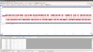

I have a SN65HVD1477 connected to a TI TIva microcontroller that I can't seem to receive data from. UART is being transmitted from Tiva microcontroller correctly, probing the D, and R pins of the SN65HVD1477 shows that data is being transmitted from the MCU correctly,
Tiva UART Data.csv
Data is being received by a DTech USB 2.0 to RS485 adapter,
The data from the COM adapter is a bunch of carriage returns,
Has anyone experienced this problem?

    So the communication is fine until the terminal tries to interpret it? Is it possible that noise from the COM adapter is corrupting the signal? If the R waveform from the RS485 transceiver to the COM adapter looks good, I'm not sure what else it could be.
    Eric Hackett
  • I suspect the baud rate is wrong. Try sending something from the PC, and compare the bit lengths in the waveforms.
  • The communication is fine on D until it goes through the SN65HVD1477. The differential output on Y and Z appears to mess up the UART data being transmitted.
    Blue (R Pin), Red (D Pin), Gold (Y-Z Pins)
    Below is the UART data from Channel B (Red).
    Below is the UART data from the output,
  • The red and gold waveforms have the same shape. Nothing looks wrong.
    I do not know why your oscilloscope is not able to decode the differential signal. Try changing the threshold to zero.
    Check that the two +/- signals are not exchanged.
  • Clemens,
    You were right it was a baud rate problem. Although I am not sure why. The baud rate is somehow slower than what it is set to in the microcontroller.
