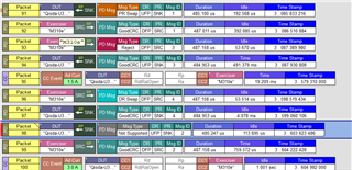

Below is the CC log of TPS65987.
My customer has two fail item in Data-Role and Power-Role Swap
1.) Fail item : TEST.PD.PROT.SNK.10
On packet 98, the Msg Type show "Not Supported" and I also read the datasheet.

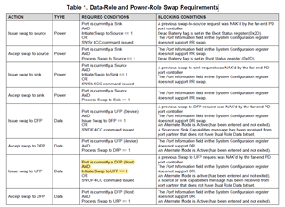

If want to swap to UFP, the datasheet said "Port is currently a DFP (Host) AND Initiate Swap to UFP == 1" So I check the FW and it is correct.
But I do not understand why it cannot supported. Could you tell me where I can check first?

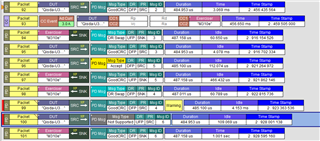

2.) Fail item : TEST.PD.PROT.SRC.7
I think Packet DUT should be UFP not DFP after DR Swap from packet 94. Could team give me some suggestions?
