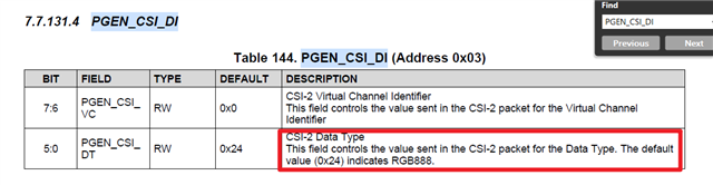

DS90UB953-Q1: Pattern only have RGB888
Part Number: DS90UB953-Q1
Hi Team,
May I ask if I want to set up YUV422 8bit output of Pattern? How could I set PGEN_CSI_DT value?
I only know 0x24 is RGB888. What about others? I would like to use APL to generate. But it seems that I even change the data type and disable register, the register can't be update if I don't connect a 953/960
