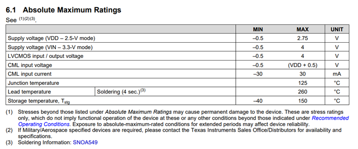

At my customer design, 3.3V could be applied to DS100MB203 SCL, SDA, SEL0 and SEL1 pin when VDD/VIN are off (0V).
They have a couple of questions as follows.
Q1:
SEL0 and SEL1 are LVCMOS input pins. Since Absolute Maximum Ratings of LVCMOS input / output voltage is -0.5V to +4V, applying 3.3V to SEL0 and SEL1 when VDD/VIN=0V is OK?
Q2:

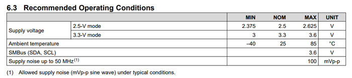

How about SCL and SDA? They could be LVCMOS input or Open drain output when VDD is on. When VDD/VIN are off, 3.3V could be applied to SCL and SDA with no damage?
K.Hirano
  • Hi K.Hirano,
    Q1:
    Based on the absolute maximum ratings (below), applying 3.3V to LVCMOS pins without VDD/VIN should not cause permanent device damage.  However, please note footnote (1) below the absolute maximum ratings.  It is not recommended to regularly operate the device beyond the recommended operating conditions and doing so may impact device reliability.  For LVCMOS, the recommended operating condition is not specified, so I would recommend looking at the LVCMOS electrical parameters, which reference VIH-max as VDD.
    Based on the recommended operating conditions, there is no VDD/VIN dependency on SCL/SDA, so it should be fine to apply 3.3V to these pins without device power.
