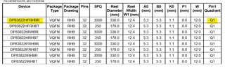

Our customer would like to know the proper quadrant where pin 1 of DP83822 is located. Datasheet shows Q1 (page 123) and Q2 (page 119).

Hi Sreenivasa,
We are referring to this datasheet: https://www.ti.com/lit/ds/symlink/dp83822hf.pdf
Page:119
Page123:
Cedrick

This is placement of the device inside the reel. On the device the pin 1 is always the same.

There are 2 information about on the datasheet which is conflicting.
So the customer wants to know, which one is correct?

Based on the datasheet information on page119 should be the right one.

Page 123 - Quadrant 1 seems to be the correct information.
